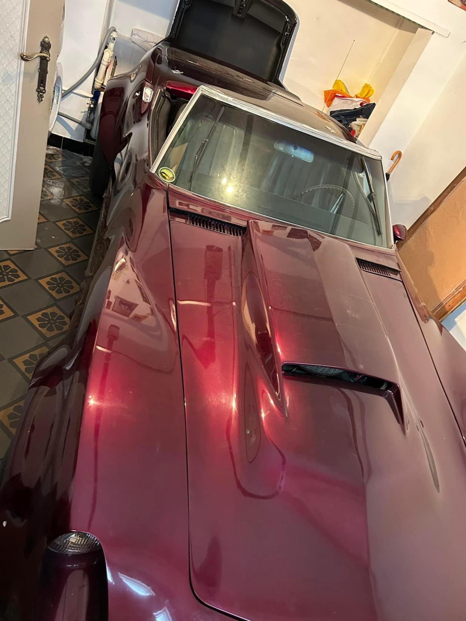

Saw this post on FB; anyone know this Vette, and if it's a real BM?

time to run the vin for what dealer sold it

I strongly doubt its a BM Vette. Joel always started with BB engines in his Vettes not SB. IMO it's a Vette with BM fiberglass kit/add-ons.
And AFAIK, he never built a Motion Phase III GT Corvette convertible. All 10 cars are coupes.
At least three of the Corvette articles I posted from Hi Performance Cars say from 1970 on the Motion GT Corvette was available with a 350 or 454. I've never seen a convertible either but Joel did ship a lot of cars oversee so you never know. Would love to see the NCRS report on this one too.

----Back in the late 60's I liked certain Motion mods and wanted to do some on my 69 435hp coupe (I never did). I must have looked at the pics of thier front headlight treatment many, many times and still do. This converts front end seems to have a different treatment on the sunken headlights. They seem much deeper sunk into the fender than other real Motion cars. Maybe just a further mod, but it's certainly not Motion!....Bill S

I think he is saying he told the country its a 350 but its a BBC. Has a high redline tach.
Jason
Correct. The car would either be disallowed for import into the country and/or more heavily tariffed if the authorities knew it had a 7or 8 litre engine. He pulled a sneaky.

Probably said it had "at least 350 cubic inches"

You can easily see the headlights are NOT the same. The kit may not have even come from Motion at all. Could have come from FiberFab
