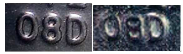

Pretty car with cool options and, well, the LSA engine. Thoughts on the trim tag originality?

You be the judge.

Reproduction cowl tag

Not sure it matters much given the restomod. Not sure why a fellow would restomod a Z with original engine / trans.
Aftermarket rivets certainly causes suspicion.
Agree with William. Here is a close up of the date stamp from three weeks earlier.
I hesitate to post this, as TrimTags.com will likely correct the error. They are getting harder to spot.
Steve: if you think the hobby is better served without making this info public, I am fine with you deleting my post.

To each their own Rally. Plus those rivets look sus, it's probably not even a real z.

Lynn the tag is easy to spot if you know what to look for and its one of the newer versions.

The outline of the original tag behind the repro is a dead giveaway.
