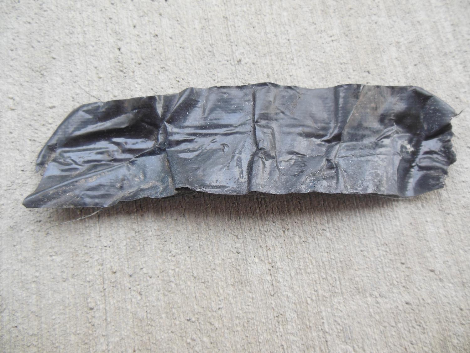

here is a sample of the original tape on the harness its vinyl on the out side and mesh on the inside
The tape that was on my cars was a 2 side sticky tape i went through legends and they said it was correct
do you have a picture of the tape you used thanks
ALLZS, Wow look at this rear harness on Facebook.
Link https://www.facebook.com/photo?fbid=...71228623122319 Your Sample has, as does this removed rear the Plastic tape AND the Mesh. I reworked my 69 Pacers rear years ago and do not recall the Mesh. I know of no exact-reproduction tape out there at this time. I will peruse the 3M web site, It Certainly WAS not adhesive coated on BOTH sides.

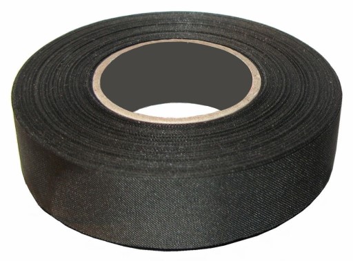

I used this 1" wide cloth tape from American Autowire
https://americanautowire.com/product...tape-pm485-007
