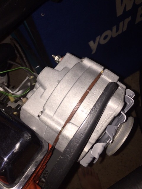

Chuck, I run my intakes thru a wheelabrator. heres a couple pics.

Donnie, Thanks for the reply along with pictures............however the FLASH washed out any detail.
Can you provide us with any detail on the exact sized media used ?
Any damage to machined surface or reason to protect ??
Thanks

Vibratory media tumbled Alt case....with and without flash. Same results with intakes and valve covers. Media is a 3/8 thick by 3/4 triangular shaped stone, I run it as "wet" as I can with H20 and a light oil/ rust inhibitor. While not needed with aluminum, it helps keep the media wet and lathers up nicely.
