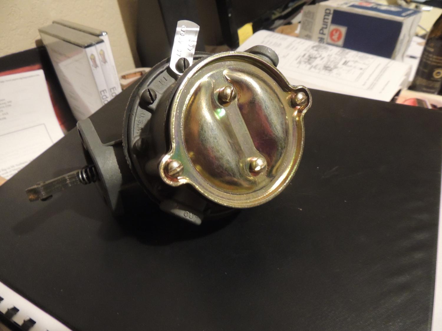

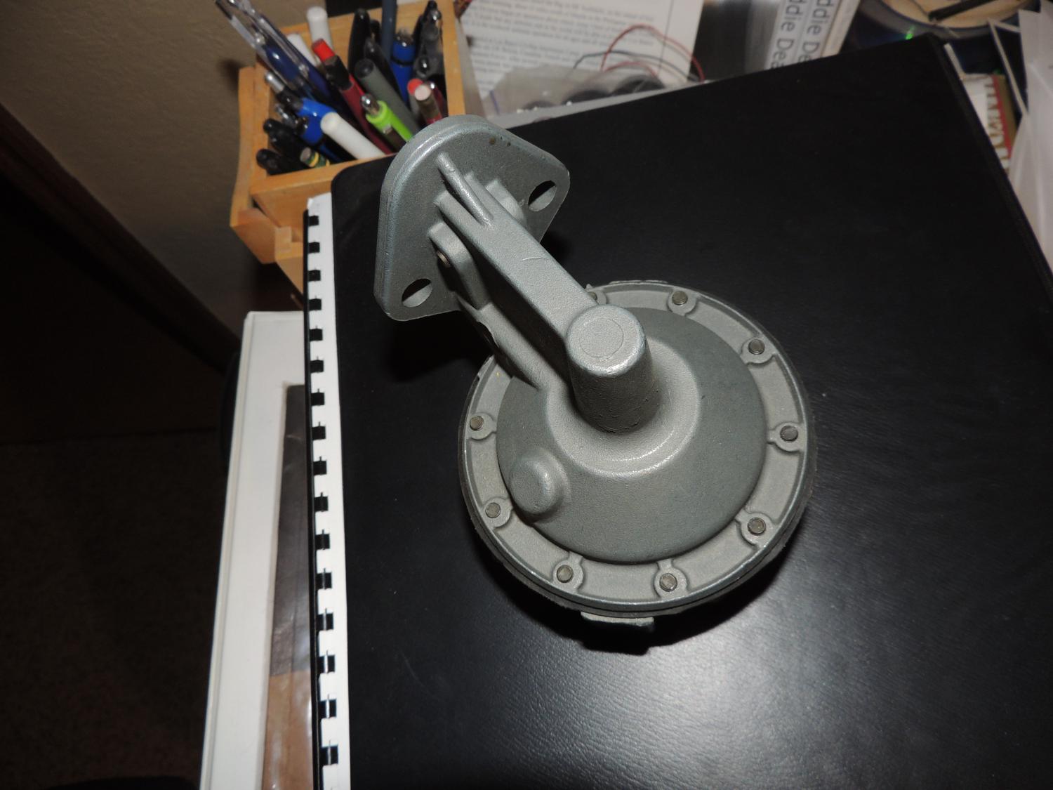

I would have purchased this in either the late 70s, or around 1996 or around 2001. Went on a few buying sprees using the old Chevy High Performance Catalogue. I cannot find any date on the box. Pump has an aluminum tag that reads "AC 40083" and below that: "469" I think.
AC is NOT embossed on the pump anywhere that I can see.
I do not believe this is assembly line correct. It is an over the counter HP pump.
My camera is down at the shop. Headed that way in a little bit. Will post pics when I get back.
Need some informed opinions.
Thanks for any help.

Sorry for the crappy tag pics. Just too shiny. Can't get it to show well.
This pump has 1/4 inch pipe thread for inlet and outlet. It can easily be re-clocked to the correct position to use on my 57 Dual Four engine. It won't be technically correct, but not sure I care that much for a driver. Car will never be judged. Best thing about these HP pumps is they are rebuildable by ANYONE with basic skills and they can be re-clocked, which is what I would do with this one to make the inlet outlet line up with what I need for the 57.
The correct fuel pump (4346) for my engine is anywhere from $450 (needing a rebuild) to $800.
Looks to me like a no brainer to just use this one.

If you do'nt care about the numbers - Just use it.
The 40083 pump that has good value is the one with the AC logo on the top, and part number on the Flange.
Yours is a GM later part, the die hards don't use those.

That is what I figured Jeff. Planning to use on the dual four engine. I like that I can remove the bottom and re-clock if for clearance.
Original dual quad fuel pumps bring big $$$. I think I paid like $40 for this one many years ago.
