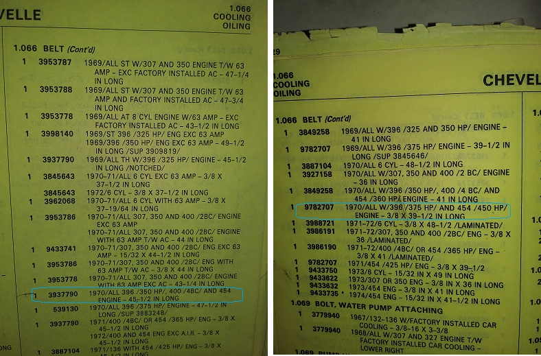

Here are some sizes from GM parts catalogue that might help. 9782707 power steering belt, 3937790 fan and alternator, no listing for air pump.
