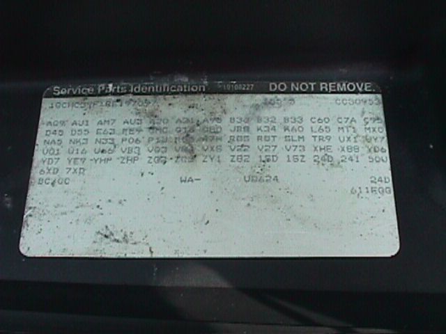

I am wondering if anyone has ever seen a Cat V8 Turbo Diesel in a Chev 1 ton Dually? I am looking at one and it is real nice and my buddy is all excited that it has a Turbo V8 Cat motor from the factory in it.
he says, it is the best Diesel motor that I could have for over the road use. Of course he is a over the road truck driver, so he feels that he really knows diesel motors. Of course after 26 years at it, I am not so sure that he not right.
This is a 118k mile unit and is clean as can be. I had my heart all set for a 2002-3 Dodge with the Cummings and a 6 speed but this is so clean that I am considering it instead. The price is only a little over $9,000 so that is also a big consideration after buying the Nova.
That is almost $17,000 less and it would also leave me more money to buy a new 5th wheel trailer. My current rig is a '78 454 Chev dually and a '78 Chapparal 32' dual axle trailer. I for sure want to get a triple for the safety of the extra axle.
Does anybody deal in these things and have a value that this truck might be worth?
I am a little concerned about the chev auto Tranny that it could give me trouble. I am sure that the motor can be repaired by any diesel shop anywhere in the country and with only 100k on it I would not expect to have too many problems with it for a year or so which is all I plan on using it. I am putting out too much money this year with the new garage and everything else I am trying to do.
I would like to try to try to buy this one so if you know anything about this special ordered,(COPO???) motor combo please let me know either good or bad? (Would this qualifity as a "Super Truck" I wonder..????)

Unfortunately, not from the factory. In '94 the medium duty CAT diesel would have been the 3116, which was an I6. This replaced the 3208 somewhere around 1990(Moparts?), but it was a V8...but NEITHER of those went into a 1-ton.
I have heard of people transplanting 3208s into trucks, but I've personally never seen one. As for the auto tranny, being as the truck is a '94 it's gonna have the 4L80E, and I went through 2 of them in my '91...and this was PRIOR to my Paxton install. While the 4L80E is an electronic 400TH with overdrive, it's rediculously expensive to rebuild/replace if you trash it...trust me, 5 years ago when I went through it it was in the $2k neighborhood. I ended up going with a HD 4-speed with a gear splitter...

Which Cat is it? The only V8 I can think of would be a 3208 and that one would have to be really shoe horned in there. They are big. Find out the model number, how many miles are on the engine itself, if it's been properly maintained including the proper coolant additive and cooling system maint. etc. The V8's are smooth but hard to get the torque of the inline 6. Fuel mileage may not be as good either. It depends on which Cat it is.
