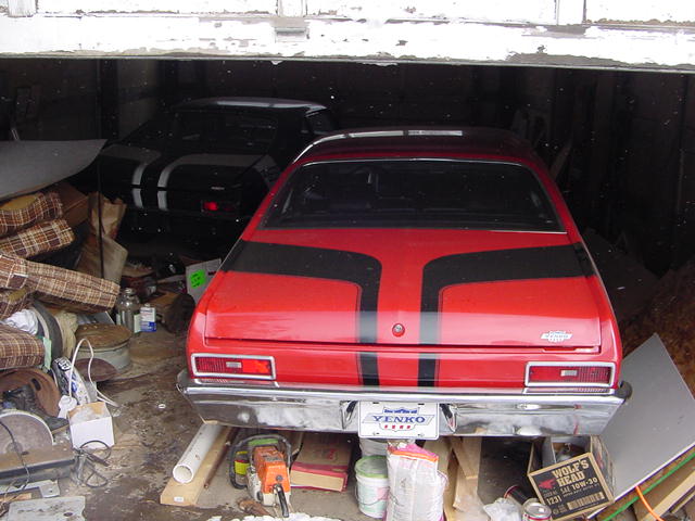

Joey show them how NOT to store a car for the winter!

Like this?

<font color="blue">Well, you should make sure there is
lots of stuff all around to keep it warm!
Man, I'm getting a lotta use outta this picture!</font>
