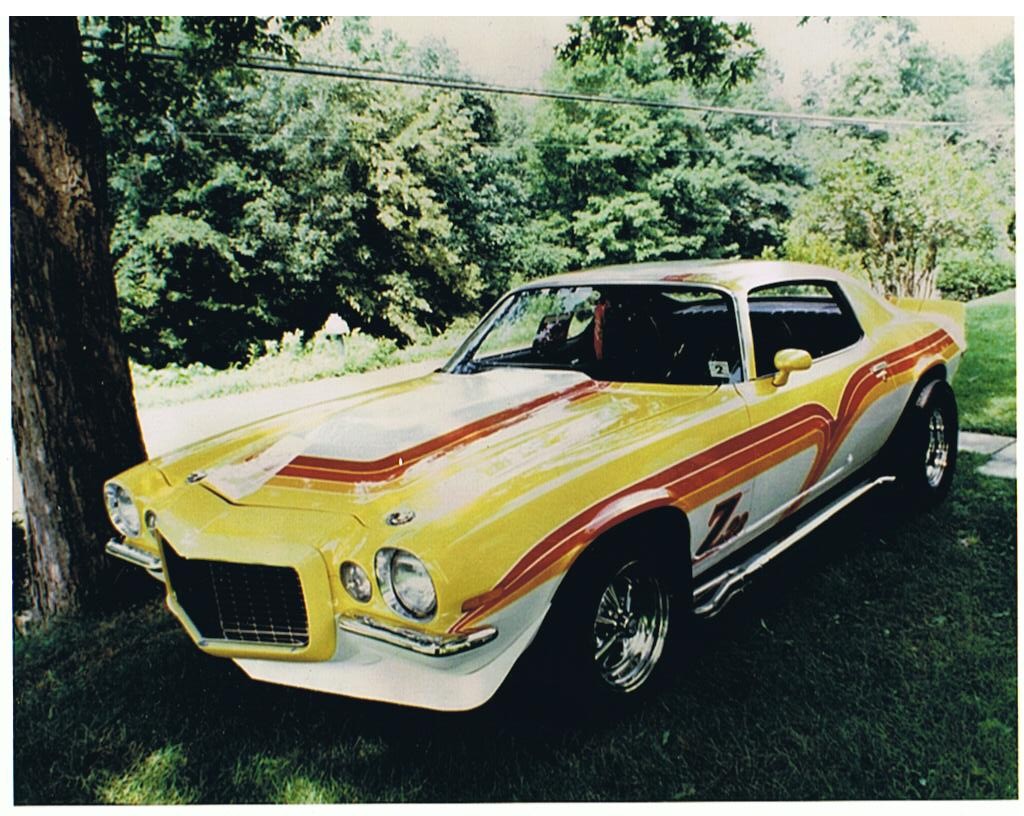

Is it true, or is there at least some evidence, that a T in the 5th position of the VIN# on a 1973 Camaro indicates a true Z28?

true
no T, no Z
Fifth digit is engine code: D = 250ci, F = 307ci, H = 350ci, 2v, K = 350ci 4bbl, T = 350ci, Z28

This was copied directly from the Nasty Z28 1973 forum....Like Jim says, if the vin from a 1973 Camaro doesn't have a "T" it's not a real Z28. I too highly recommend the Nasty Z28 web site....lots of great info from some very knowledgeable people on second gen Camaros!
"Z28 Verification: The 5th digit of the VIN will read "T". Period.
Total Production: 11,574 (6107 w/Manual Trans, 5467 w/Auto Trans) "

If it has a S , that is for the LT option. There will be no z28 emblems when with LT option. The fenders will just have "camaro", and "350" emblems. The LT emblem will be on the rear roof pillar and LT on front header and rear body. Z28 stripes were an option in 73.
