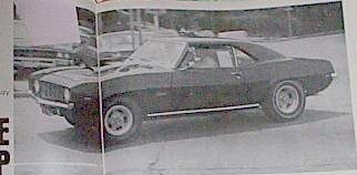

I'm in the process of restoring my 69 BM Camaro and wanted to solicit some opinions on tires. For wheels I will be using Crager SS.
Attachments - The Supercar Registry 49537-MPtire49.jpg 49416-mpcam6947.jpg 49414-mpcam6946.jpg 48744-File0018.jpg

I thought I would bump this post back up to get a few more opinions. I will be running 15x8 Cragers SS on the rear and 15x6 up front. My understanding is the largest rear tire that will fit in the wheel wells is equivalent to a 235x60Rx15. The car will be Daytona Yellow with black striping and mid-year corvette side exhaust. I was planning to make a run up to Chattanooga in the next few days to pick up the tires from Coker Tire so I need to make a decision soon. Thanks

Is this the tire look you are going for?
Pro Trac has a repro tire on thier site p235/60-15 that is 27x10x15. This may be the closest you can get to the old Ingelwoods but I am not sure of all tires that are available today. Joel used to roll in the inner edge of the q-panel to get more clearance. Funny thing on my 87 Motion Monte SS, Joel put wide 16" wheels and he rolled in the wheelwell. He built cars the same way for over 30 yrs [img]/ubbthreads/images/graemlins/biggthumpup.gif[/img]

I would not run the small 235 on the rear-looks dorky. I would run 275-60-15 Pro-Tracs. I know they will fit without any rubbing. I just saw a pic of a '69 that ran 15x8 Cragars and 275-60 M/T's and the car was not raised. As a bonus the Pro-tracs are just slightly less in width than the m/t/s and actually came out before the M/T's in '70 so they are more correct for your application anyway. L-60-15 (275-60) M/T's were introduced in March '71. Pro Tracs came out in mid to late '70' based on the ads I've seen.
I think with rims/tires if not sure what to run always go bigger to be safe. A bigger tire looks less dorky than e smaller tire.
I'll post the pic tomorrow. You will agree the 275 looks best once you see it.
