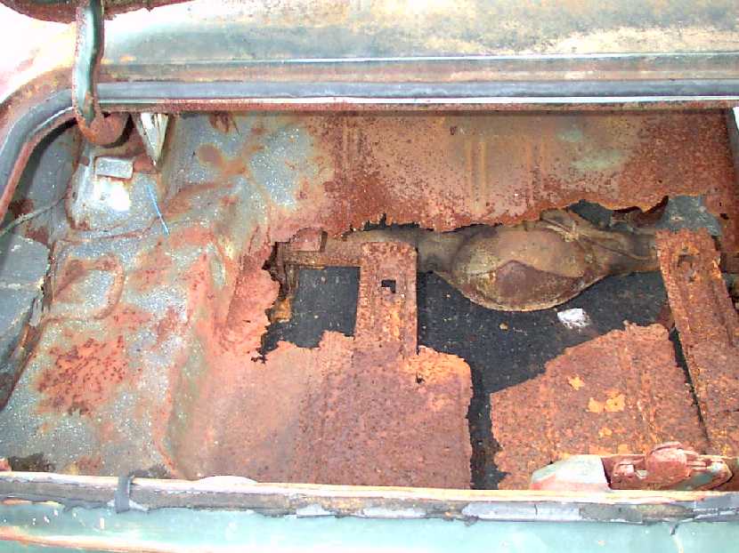

And if so how and by who? What happens when a car thats certifed as a COPO type car is later found to be a rebodied?
(I opened this one up in a different thread since it started to take away from the COPO Chevelle that a member posted for sale.
Attachments - The Supercar Registry 170774-TrunkCenterResize.JPG 170738-SideLHresize.jpg 170468-bobrebody.jpg
