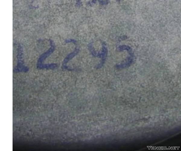

ink stamp on back reads: 6412295

Ok, that's interesting, my parts book doesn't list it! Close, but not that number. Are you sure the last number is a "5"?

I'm showing Tachometer part #6412293 for your application.

here is a pic of his tach...
