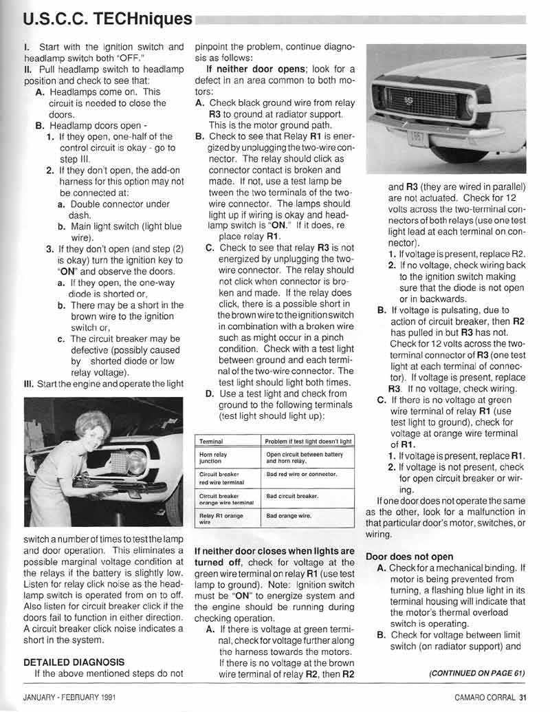

Scan of a multipage article in January-February 1991 issue of Camaro Corral.
First page:
Second page:
Third page:
Like an idiot, I failed to notice the article is continued on Page 61. Unfortunately, I already sent the magazines back to the person I borrowed them from to do the scanning. So... if anyone has the January-February 1991 issue of Camaro Corral and would be willing to scan the rest of the article, I'ld be much obliged.

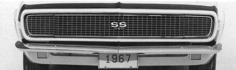

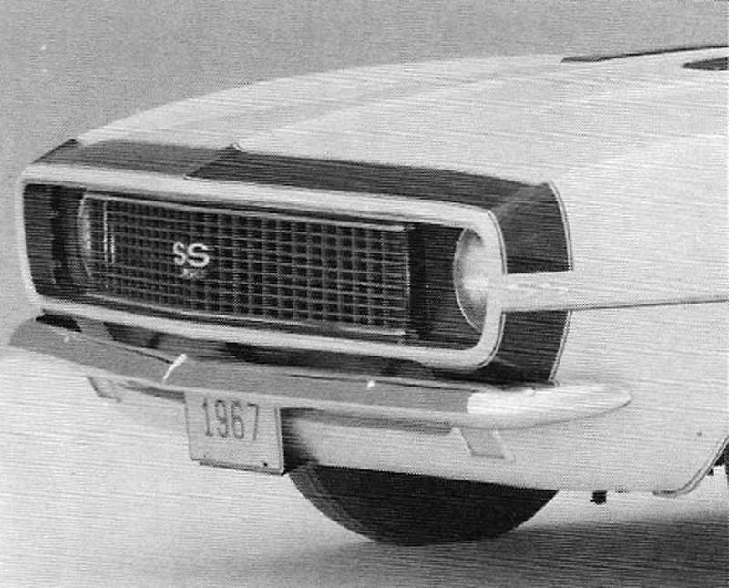

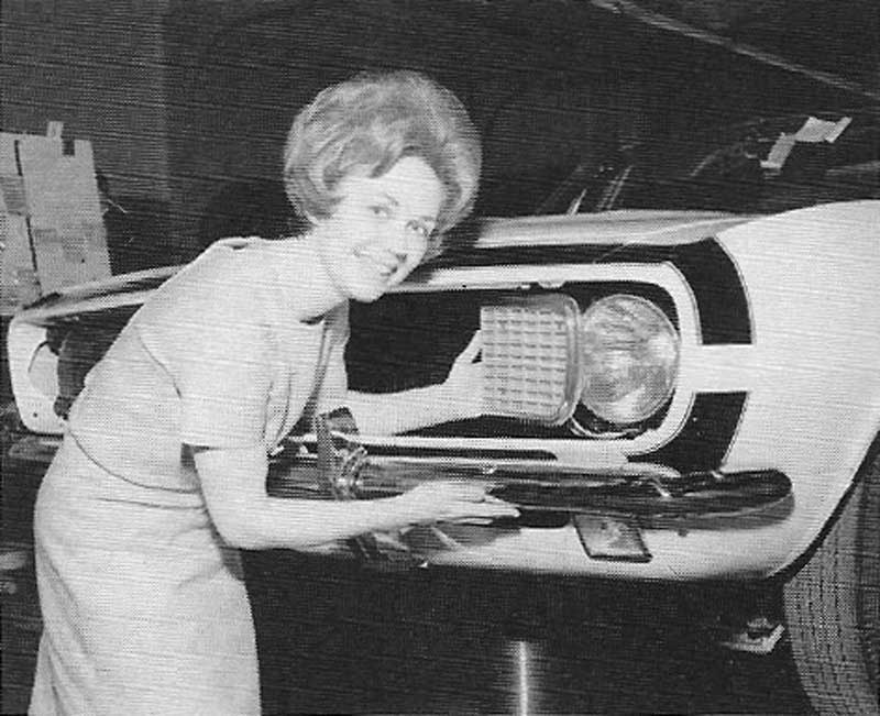

The vintage GM photos in the article are interesting in their own right. Here they are again, but not so reduced as those in the fullpage scans earlier:

Be aware that some repo electric door motors were wired backwards. I fought with a 67 rs for quite a while a few years ago. Everything was correct, but the doors wouldn't open. They acted like they were reversed. So I called the place I got the motors from and asked if they had anyone with similar problems. Well, they said, "we don't make these, we buy them from another vendor, and some are wired backwards". We changed them around, and they worked fine. A fricken recall notice would have been REAL nice.
