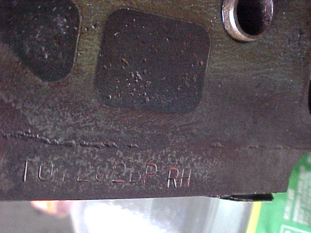

here is a photo of a 427 motor, 321 casting , 4bolt main...
....Can anyone tell me what it came in?
...it is dated F167

is the suffix "BPRH" ?!

...that is the last four digits....I think RH may be someone's initials....but I do not know...

upon checking two of the most used sites (below) I do not see those codes even coming close to a 68 427
(all suffix appear to start with an "I" for that motor)
http://www.chevy-camaro.com/chevy-ca...s.asp?group=11
http://www.nastyz28.com/chevy-engine...ngs.php#suffix

Anytime i have had a block with too many numerals for the month and day,and also when the Letter suffix started with a A or B [usually but not always]it has been marine application. I used to buy blocks from Marinas in CT and RI and each time they were either non stamped[for 66 and 67] or A,B with 5 numerals in the case of 1968 and 1969 vintage blocks. Most but not all have been AA or BA...
I agree. This too has been my experience.
