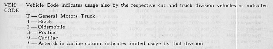

i found a 4 speed case. can someone tell what these numbers mean?
3925660
p9505a
39m216441
THANKS

3 is Olds? Is my P&A wrong???
(By the way, it doesn't show it but 5 is listed as Chevrolet. Didn't want everyone to think there was no Chebby division!!)

Old 01-03-2007, 02:27 AM
bertfam bertfam is offline
Location: Southern California
Posts: 228
Thanked 2 Times in 1 Post
Default Re: 4 speed question
You know, I just looked at that again. 1 is listed as Buick, but we all know that 1 is Chevrolet!! What gives? This is from my 1971 P&A 26 (Dealer Parts and Accessories Price Schedule). This book must use a different coding than what's normally used.
Sorry about that guys.
Ed

Yup. Found the designations on THIS SITE (about half way down).
Position 1: Division Identification
Always 1 for Chevrolet
(2 = Pontiac, 3 = Oldsmobile, 4 = Buick, 5 = GM Overseas, 6 = Cadillac, 7 = GM of Canada
9 = GM Overseas, C = Chevy Truck, T = GMC Truck)
