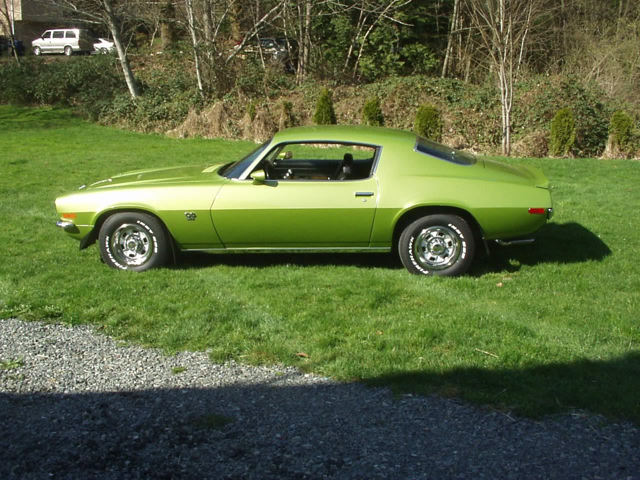

Below are three pics of three different 1970 L-34 Camaros showing ORIGINAL 239 Open Element A/C's
