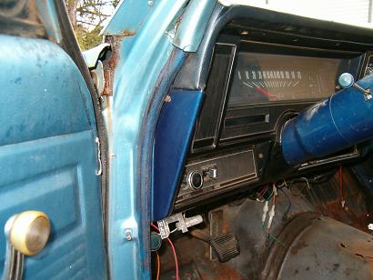

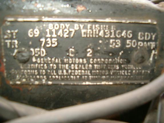

A friend is getting ready to paint his Fathom Green Nova SS. The car has the lower rocker trim. His question were the rockers blacked out on this color? I know that certain Camaro colors did not recieve blackout. Did this also apply to Novas? Thanks in advance...BKH
