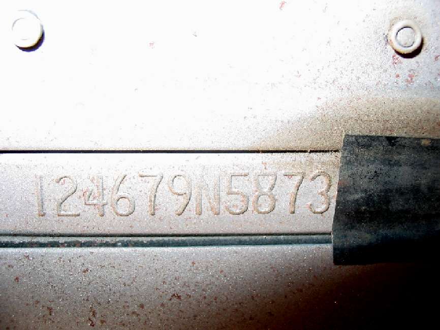

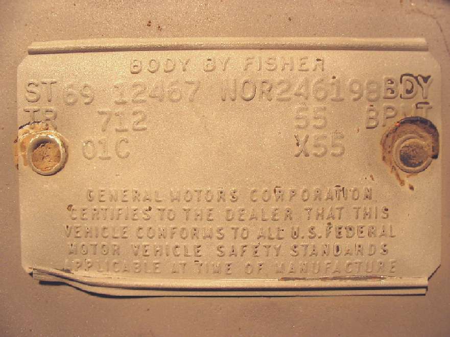

From what I've read it would seem that a 69 camaro with a X55 cowl tag has a small block only and never a big block. I have a complete SS body, bought in late 70s that has a X55 tag but has a big block heater, heater core is dated one month before tag date, single fuel line, original big block frame mounts. Is it possible to have a X55 big block?
Attachments - The Supercar Registry 317535-vin_9N5873xx.jpg 317532-tag_9N5873xx_NOR246198_2.jpg

Most likley not. Unless the trim take is in error. Post a picture of the tag if you can, and the Vin#

I've never seen a tag that had the wrong X-code. They were computer generated from the ordering info.
I'd like to see a pic of the tag.

Thanks for the responses. Back when I purchased this car I was not aware of 'X' codes meanings. I liked the car, a convertible, it had the obvious BB heater etc. and looked like an original SS, lots of options, even had a rear window defogger. As I am not the original owner, the car may have been altered as back then all we were interested in was speed and ET and originality was unimportant. I do not have any documentation. I will take a picture of the trim tag and post it. It may take some time as the car has been stored since the early 80s with lots of parts in front and around the main body.
