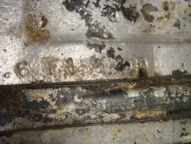

ok...heres another of those trannys that I've had for years...I believe it must be a 64 by the date...but I'm still learning...any help please....Hey verne??? hehe Thanks again!!!
and I think this one has a vin ...but it sure looks like my 5 year old niece stamped it...??? is this normal??? Sorry for the pics, its seems the trans was painted black at one point back in the day!!

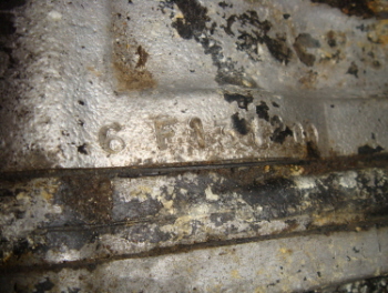

pic 2

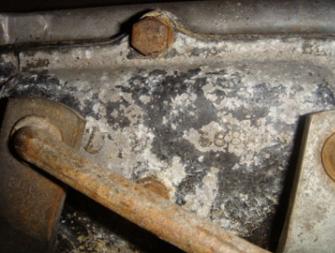

pic 3

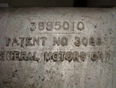

pic 4

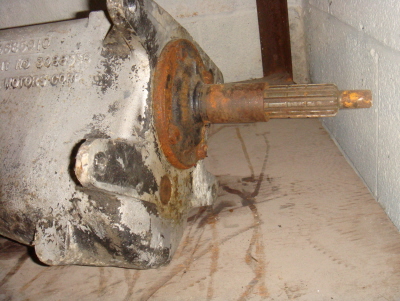

pic 5....hey is that anything like an 010 block??? hehehe

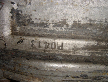

pic 6

ok...so I lied...one more here of the VIN...(I think its a VIN??)...Im not sure if this angle is a little better or not.....but I was thinking maybe its a 66 trans. by the vin??? I guess you guys will give me the real scoop!!! Thanks again!!

010 casting is 1966-67. Two grooves on input shaft is M20 2:52 wide ratio. Date is 1966 April 13. Hope this helps. http://www.gearzone.net/muncie2.htm
Old 02-11-2008, 06:19 PM
Join Date: Jul 2003
Location: Central New Jersey
Posts: 3,793
Thanks: 34
Default Re: 64 Muncie??? ID help...
I agree. It was installed at the Flint plant which made full size and Chevelle in '66. Hard to tell which it was unless someone has an idea of typical sequence numbers near the end of April.
