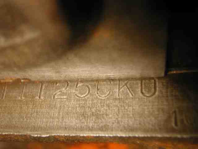

Ok, I know I am open to all kinds of opinions both good and bad. However, it seems to me that this site has more experts than any other site. I am about to finish a rotisserie restoration on my 1970 L78 Nova SS. The car has the vin on the engine and transmission. However, I have not been able to obtain any other documentation. In my limited experience, the stampings and broach marks look legitimate. Please way in on what your belief is as I will be putting the car on eBay in a few weeks and need to get the opinions out now and not while it is on eBay. I am not a dealer but a (58) years young Warden of a Correctional Facility here in Maine and I love all types of Muscle cars.
Here is what I have done and ID info regarding my 1970 L78 Nova SS:

Block Casting Number 3969854 1970 402/375hp 4-Bolt Correct
Block Casting Date J30 9 Correct Time Frames
J October
30 30th Day of October
9 1969
Block Stamping Numbers T1121CKO 10W192535 Correct
T Tonawanda Engine Plant
11 November
21 21st Day of November Correct Time Frames
CKO 402/375hp Special High Performance 4-Speed

Attachments - The Supercar Registry 333695-trans.jpg 333694-vin.jpg 333693-cko.jpg

Hi Al, The VIN stampings on the engine & trans are different, at best one or the other is not original.
Jerry

What information are you looking for? I thought the L-78 would have a steel not a cast crankshaft? I did not see any mention of the type of pistons used, forged or cast and what compression ratio? When you say reconditioned on some of the key parts does that mean the parts still have the original part number stampings and are they original to the car? Can you provide pictures of the core support?

[/ QUOTE ] Pics show 11 to 1 forged.... My question is this, if the pad stamp doesnt do it for certain people would the prescence of the right crank,pulley and cam make the stamp look more believable?

I looked at that car last year, purchased off of Long Island.? owner had a hemi RR and a LS6 Chevelle as I recall. Car needed a ton of work and price was a bit steep but it looks like you have done nice job. As someone indicated previouslyl, see if you can get an NICB report and try trace ownership that way. Engine stamp looks real, don't know on the tranny. Good luck
