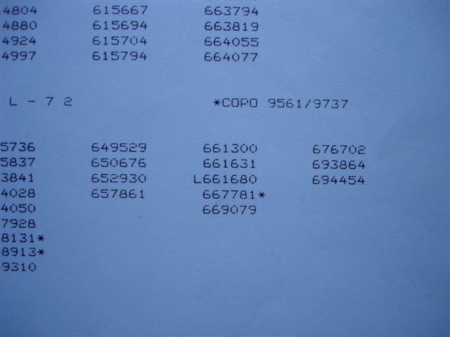

Any opinions ? I have heard of a few VN COPO's but it always seems like there is some story or in the end they don't check out
http://cgi.ebay.com/ebaymotors/Chevrolet...tem330294302791
Some Chevys and some old race cars
Attachments - The Supercar Registry 375787-CopoConnectionpage59VIN661631.jpg

seems there is no paperwork.
There is an anonymous $300,000.00 apraisal.

That would be one very early COPO 9561 Camaro based on that pad date.

cast iron block with aluminum headed copo? never heard of that before.

BUYER BEWARE.

I could not see any broach marks in the pic, plus T's (not I's)were substituted for the 1's. I's yes, T's no. I would be very suspect.

OTC 077 heads, OTC Holley carb, OTC Chevelle style air cleaner ring, non smog ex manifolds. Looks like a put together top end. That's not really uncommon in this area though. If the car came from Elkhart and was raced all its life, it must have been raced out of the area, cause I don't remember seeing it, or it may have had a color change along the way. Anyone got a name on the seller?

Ive never seen an insurance appraisal like this one!
"the engine is going to be redone and replaced in the car" WHAAAAT????
