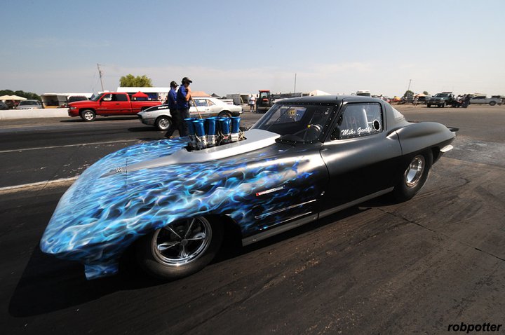

We ran a best of 8.40 at 161 mph .. 1.16 sixty foot .. on the motor ..

<div class="ubbcode-block"><div class="ubbcode-header">Originally Posted By: ZL1mike</div><div class="ubbcode-body">This Summer at the drags with my son .. </div></div> Look he is running&quot;No air filters No Scoop&quot;.

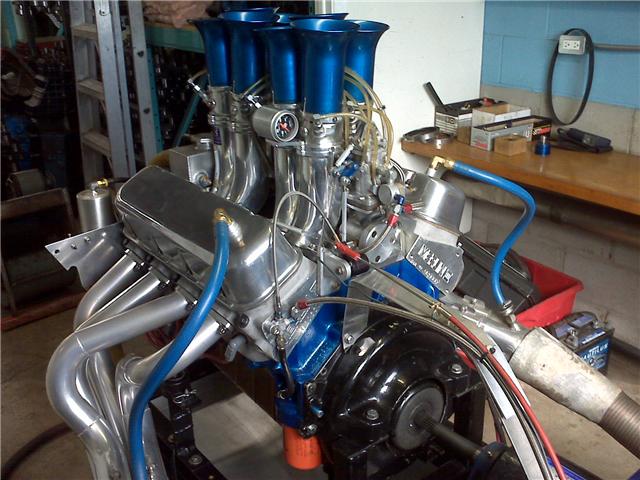

that looks similar to an old school lucas injection set up like mclarens ran. what is it? i need some engine specs on this bad boy.

I use the hood,but at 8.40 at 161 mph,I would think more[a scoop]. *Paul

I built this race car as old skool as I could .. 540 ci 13.8 comp..Kinsler mechanical Fuel Injection with Lucas fuel distributor and fuel pumps.. Electromotive coil packs... VP C12 gasoline..
yes it is agreat ride...
