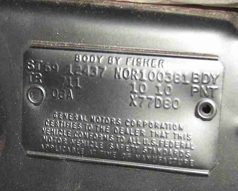

Like William said: BDY reset. Here is my 08A tag with an even lower number:

Lynn,
That's a low one! Your VIN must be close to 124379N670000.
The reset is something that I didn't know and that's why I'm glad somebody pointed it out. I can understand why they reset it (probably to have a standard of always resetting in August), but without the VIN to match with the cowl tag the numbers can get confusing. It would have been less confusing and kept the numbers further apart if they reset on 07A. Plus I hadn't read about the resetting of the numbers before.
