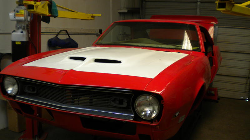

Hi Guys and galls,
I am new in this site and need some help as to what is an acceptable mod and what is a no-no for a Yenco. I am restoring a 68 comaro and so far have the correct snorkel hood, a 427 with patriot heads, a t400, and 12 bolt rear with 4 leaf springs and 4 wheel discs. I am looking for a genuine block and heads to go with a powerglide to put in at a later stage.
I have the gauge console,tictoc tack and 140 speedo and intend to paint it matador red.
my question is what is acceptable ?? headders, brakes,ect and what is not like paint, trans, hood, decals, wheels.
Cheers: auschris

Welcome to the site. There can be a pretty steep learning curve here. For starters it's Yenko with a "k".
You'll find it can be tricky building a socailly acceptable clone. I would recommend you build the car the way you want to and not worry about anything else. I personally feel you could just try and keep it as a "period build" using all the parts which would be correct to a certain time-line. Say speed parts form 1968-1970 for example. it doesn't have to be a Yenko Clone to be cool!
Got any pics of your project?

ps:I will post some pics soon (have to reduce size)
