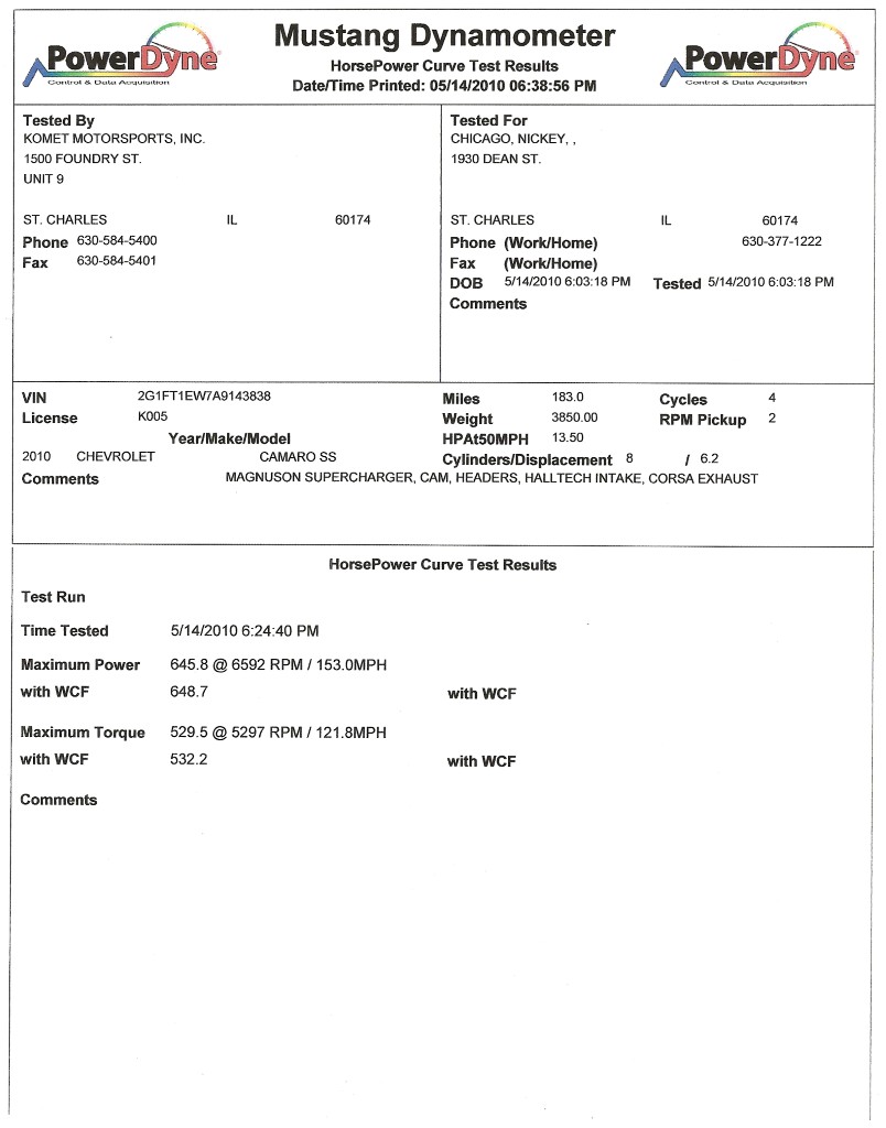

We added a Magnuson Supercharger on top of the 600hp Stage II and achieved over 750fwhp!
