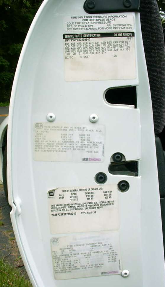

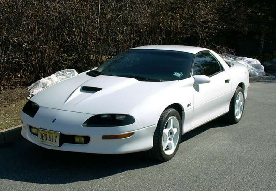

If the door stickers are still intact there will be rpo codes for the SS and some other SS specific options. Also look for the SLP door stickers. I think the passenger door gets one with specific SS options. Look for the WU8 RPO code. I think there should also be an SLP sticker on the radiator cover as well. This was from my 96 SS hardtop car.

Those pictures help a ton, Jeff. Thanks for posting them.

I think one of the rpo codes is actually called &quot;hood for transport&quot; or something like that. They must have put some plain hood on the cars to get it over to SLP where the SS hood was added. I had some 17x9 and 17x11 wheels painted white for my 96 SS. I put longtube headers on it and some other minimal mods like plug wires and coil. I never got it tuned before I sold it, but the guy who bought it ran a 13.4 in the 1/4 mile without a tune. Not bad for an automatic.
