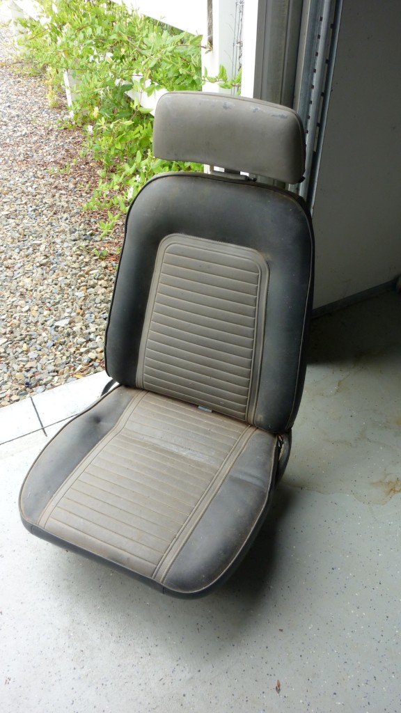

After I found my JL8 car I contacted Wayne Guinn (author of Camaro Untold Secrets) and explained to him what I had. We had several email discussions about the car and in one discussion he asked if there was anything unusual (other than the options) about the car. I told him the seats were two-tone and he suggested the car may have been used as a promotional car for Chevrolet to showcase their 4 wheel disc brake system. I have included a picture of the seats.
Question is does anybody have recollection of Chevrolet doing that kind of thing back then?

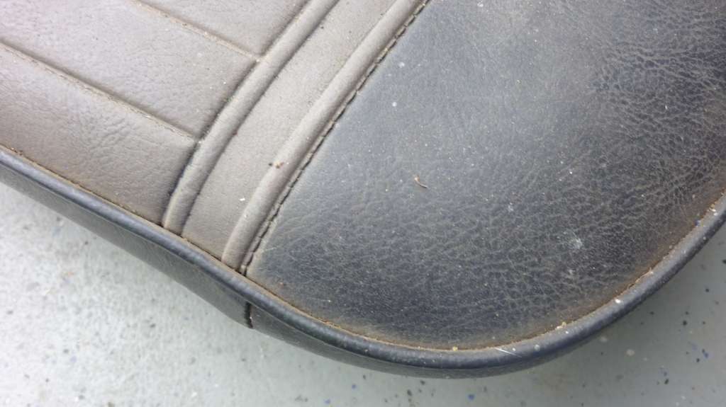

I have never seen any evidence of a direct marketing effort for the JL8 option. Chevy did little Z/28 marketing, only running one print ad "We've got a mean streak" which mentions JL8. Several magazines covered the release of the service package axle in '68 and a '69 JL8 car was tested by Car Life and Road Test. JL8 was delayed several months; earliest documented car was built late Feb '69. By June the option was discontinued. Little point in marketing an expensive option nearly impossible to get.
Your seats were likely spray-bombed by a previous owner.

If they were sprayed, someone did a good job. The close up does look like it though. You never know...could have been done by GM as easily as a dealer or owner.
