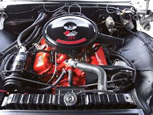

Hi guys, I have a question about chromed rocker covers and what determined which BBC got them. My lowly '66 SS 396 Impala had them, yet I've seen plenty of 435hp 427's in corvettes for example W/O them (just painted orange). I for the life of me can't remember what came on my '67 L78 Chevelle from the factory but it was heavily Day 2'd. I do believe they were chromed at delivery.
Thanks for your help.

67 L78 Chevelle would be chromed ones.

Yea Danny, I thought they were chromed. But what determined that process???

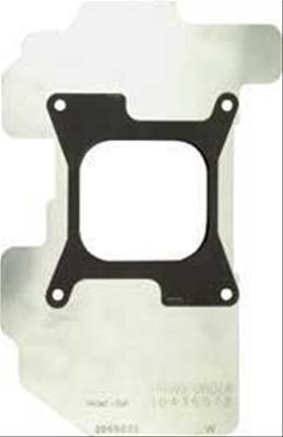

Keith, This is the part I was refering to, is that what you are calling an <span style="font-style: italic">&quot;oil heat shield?&quot;</span> I thought it was to keep the fuel in the float bowls from heat.
I'm not sure if it was OTC only or factory installed on some engines.
The rocker covers are still are a mystery...
DH [img]<<GRAEMLIN_URL>>/flag.gif[/img]

An &quot;oil heat shield' would be under the intake manifold...some manifolds had them riveted on. There was also an over the counter lifter galley oil shield that kept hot oil off the bottom of the intake manifold.

My mistake. I was referring to the one that snaps in between the heads. I put one in our L78 engine, blocked the heat crossover and added the heat shield, that you show, under the carb. If I ever have the engine out, I'll add a windage tray under the crank too. It's the little things that add up to a nice running engine.
