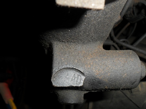

Im looking at a 4K car and it has a single master cyl on it, no booster.
Was this possible for a 67 4K (396-375hp) car?

My 4K car does not have power brakes, but it does have disc brakes with the AD stamp on the master cylinder.
Check to see what the stamping is on the front small pad of the mc.
