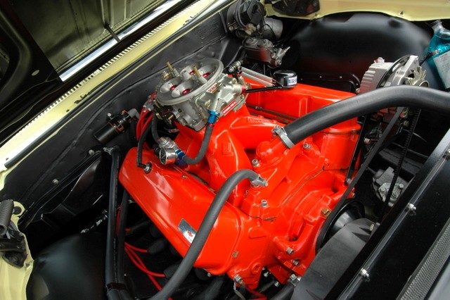

I've been toying with the idea of making some changes to my 64 Chevelle. I have had it built this way for 10 years, and while I'm not tired of the car, I thought it might be fun to make some reversible changes for the next couple of summers.
If I do, they would be of the Day 2 era.
I have two of the old Edelbrock, dual plane intakes that are Dominator flanged. I would just have to add spacers for the tall deck block. Other than that, I'm asking for ideas on everything. Wheels, tires, under hood, interior and ride height.

I would say 68 to 71 era. But again, I'm not that big on everything being dead on. In other words I'm not going to change my Spal fans and fabbed shroud.
The hood is a must have with the intake I am running at the present time. The HVH made 704 h.p. and the much shorter Performer RPM was 38 h.p. less.
But I don't really care about that stuff anymore. I should be able to go back to a flat hood with the C454 intake.
The attached picture is when I had the RPM intake installed. I took a stock Camaro air cleaner and modified it to a dual snorkle. Everything fit under the stock hood, but I had a Pro Systems 4150 carb. at that time.
BTW..the cowl hood is all steel. I made the scoop out of 18 gauge steel.
