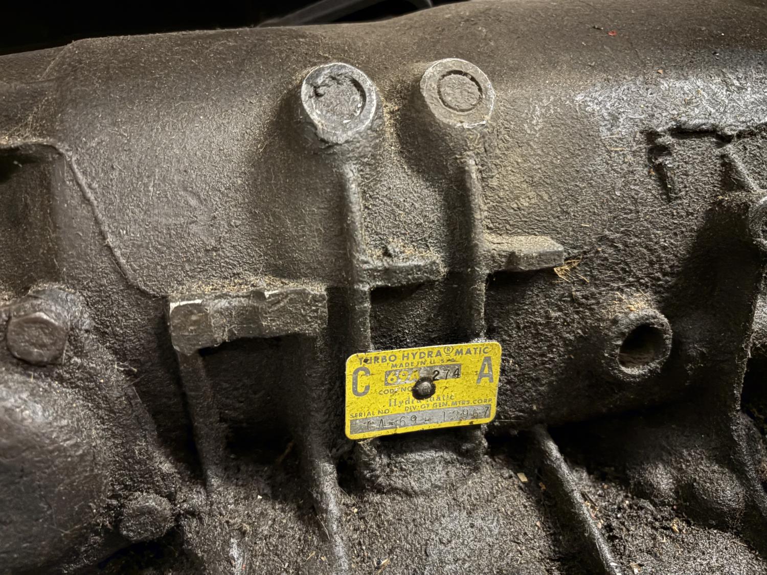

You guys are my last hope and maybe should have been my first. I recently looked at a '69 Chevrolet I was documenting with a turbo 400. It is definately dated 1969 (mid year) and has a yellow aluminum tag with "CY" on the side. (69-Y-xxx) I cannot find a "Y" code anywhere, only B, F, H and X for '69 turbo 400. It is NOT a '70 trans based on the tag date and is definately a Chevrolet trans. Someone please tell me what trans this is. HELP!!!

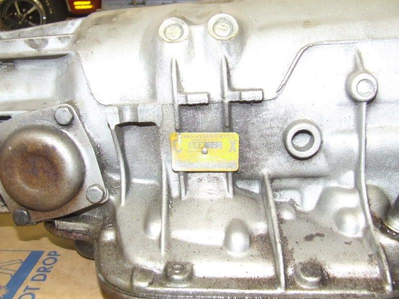

The 1969 hi po TH400 is CX code. Post the numbers on your trans tag on pass side and look for a vin no. on the vin pad on driver side just above oil pan.

"CY" coded transmissions were used in 1969 behind solid lifter Corvette applications - L71, L89, L88, and ZL1. This particular application is quite rare for Corvettes; I've been told the total number installed in 1969 was 255.
The specifications and internals of this transmission are identical to the "CX" transmissions.
