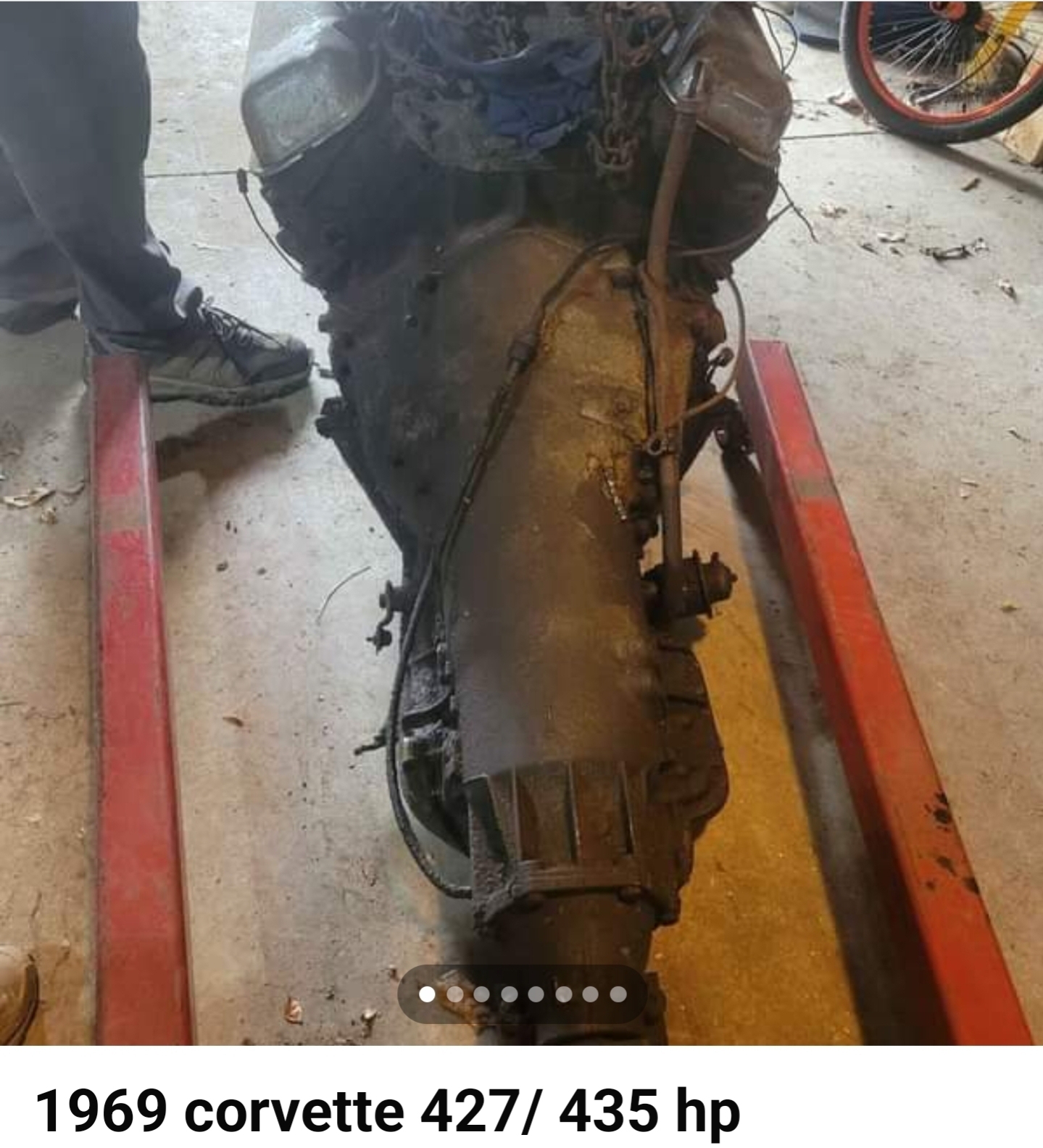

Using a 1969 "Hydra-matic Production Parts" list, I charted the differences and similarities between the "CY" & "CX" automatic transmissions, as well the difference between the "CY" & "CX" and the standard 400 automatic transmission.
Attachments - The Supercar Registry th400_partial_vin.jpg TH400 Date.JPG Screenshot_20240626_105100_Gallery.jpg IMG_0379.JPG
