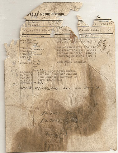

Here's a few links;
Mecum August 2012 listing...
http://www.mecum.com/auctions/lot_de...=CA0812-134031
Tank sheet...
http://www.proteam-corvette.com/cars...9L88COPO10.jpg

----Pete,,,Good find on the build sheet! I see it, but for the life of me, I dont understand it. The build sheet has the normal M-22 above that lower listing of COPO M-22. Why would the trans be mentioned twice. Ahrens build sheet isnt pictured on TMs sight, just the window sticker, so no insight there. What could have made that M-22 different enough to COPO it???.......Bill S

Perhaps there were other M22's available Bill, who knows what it all means but it'd sure be interesting getting to the bottom of it all especially w/ the 4:56 Copo 9511 situation being involved too.
Examining the ECL codes would be the best next step although I don't have any to compare with also some appear obliterated in the tank sheet pic?

I see that there is no J56 option on this Vette which was required with all L88s. Maybe that is why it's a COPO?

Lack of the manditory J56 option made this a COPO. Kind of like a no radio car being a big plus.

----But Tim,,,Why does the tank sticker say M22 and then COPO??? Thats what I dont understand.......Bill S

Maybe the trans was listed as a COPO option for the internal speedo gear to match the COPO rear gear?
