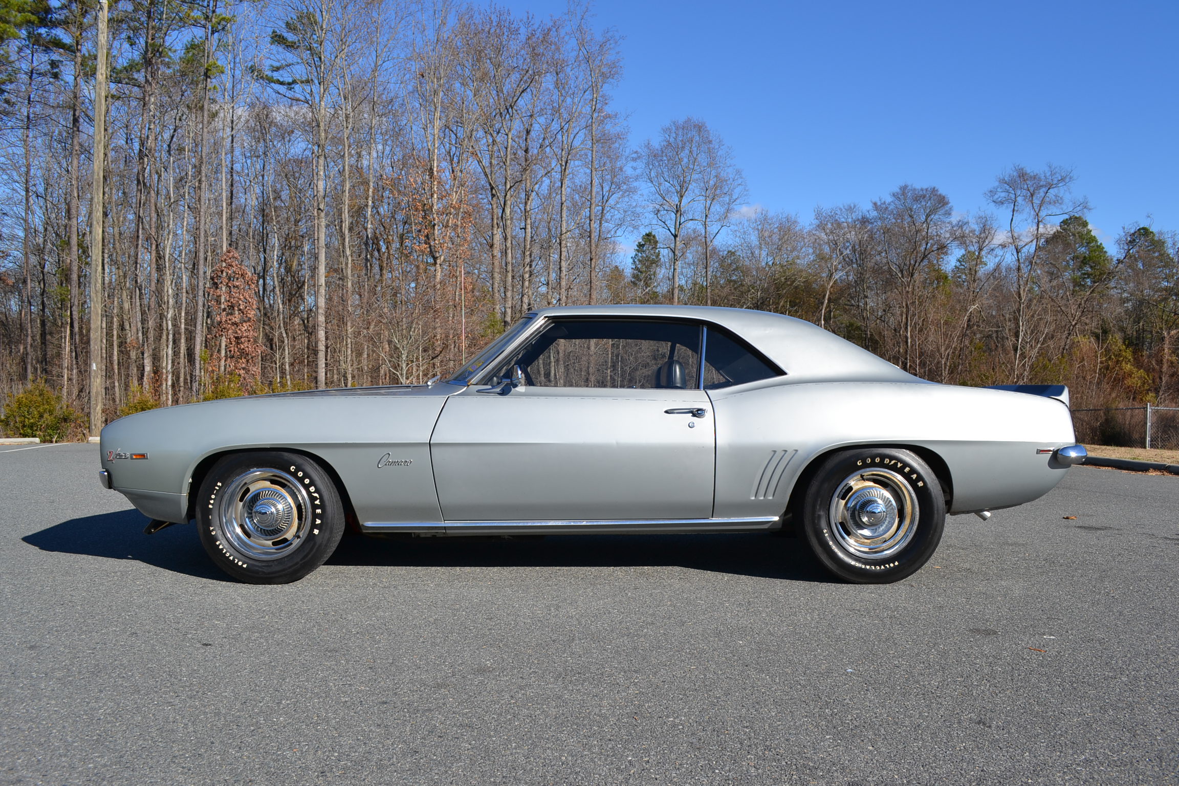

I have been polishing and buffing my butt off on the original paint 69 Z I recently bought. The side of the car looks really nice but the top of the car is just ok. The issue is that the car sat outside in the elements in the early 70's during the heyday of acid rain. The car was a Louisiana car and I am guessing that the acid and other crap from the Gulf coast refineries found there way on the top of the car. Does anyone have any good ideas on how I can polish the acid rain out of the paint?

This is what I have done so far
1. Clay barred the entire car
2. Polish compounded the car
3. Polished the car with Adams Revive Polish
4. Waxed the car with Adams Butter wax
When I polish compound the car I get a lot of black residue on the applicator and also the microfiber cloth. I am guessing this is crud off the paint and also could be some of the paint coming off the car. I probably should just keep polishing the roof which is the worst, but layoff the polish compound. I don't want to polish the paint off the car. The surprising thing for me is that the black lacquer stripes have much better shine than the top side of car.

After a lot of elbow grease the ole girl is starting to look better. Still a lot of work to do yet. Pictures are very forgiving for sure. I would post several more pictures but need to learn how to resize images.

One more picture

I know the grill is wrong. I have the original but it is damaged.
