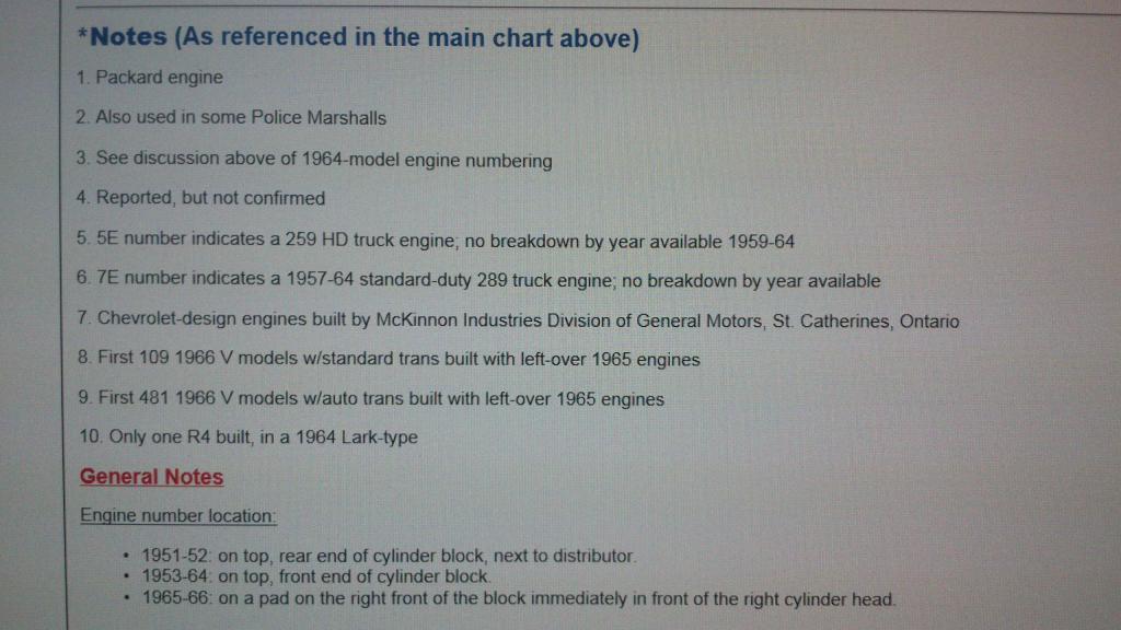

The guy that had this one said it came out of a Studebaker, which I thought was odd. Seems like suffix &quot;77&quot; was used in Studebakers as well if you look at the pics below. If the engine number starts with 776 it seems like it was used in 1966 Studebaker models.
