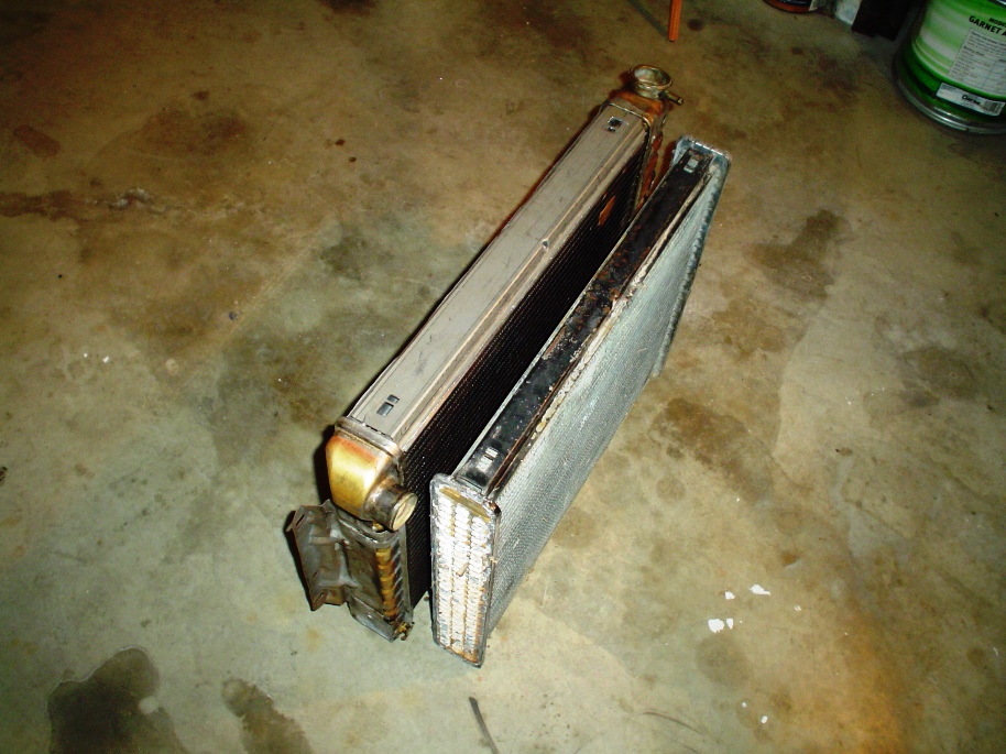

I am trying to identify this really nice camaro 4 core the only code visiable is cf under the fill. none visable on other side unless under some solder. no tag It is a harrison the top is flat and has no ''pinch'' or square holes. the brackets 100% correct. It is 21 in tank to tank thanks

I would say old school custom 4 core center just like I recently did for my Z-11. I am increasing the stock engine output to the point where I will need more capacity.
The original 3 core is pictured against the custom 4 that I had made. I went over the top reproducing the pinch marks and the notch holes for the job.

The CF tank was used on several cars. Novas and 70+ A-bodies.
It wasn't on a 1st gen.
