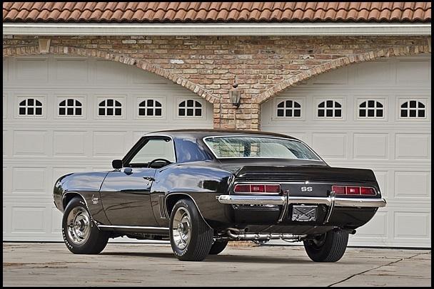

<span style="font-size: 20pt"> Don't think they missed a single thing!*
L78
L89
JL8
4 Speed
4.10
Tuxedo Black
ZL2
Z21
NC8
Endura Front Bumper
Every Piece of Factory Documentation
</span>
*i admit I am very disappointed that it doesn't have the Rally Sport option! [img]<<GRAEMLIN_URL>>/dunno.gif[/img]

OK, I was not going to go off just yet on another L89 car. Here is the e mail I just set Phil when he asked me my thoughts on this beauty, it does sit nice ?
Phil
I would not believe it untill I saw the paperwork ? It would be odd if a Norwood car had any kind of a broadcast sheet, could be Van Nuys ? If it is so great why did they not even show a picture of the cowl tag ? That way we would know if the chambered exhaust is correct. Black car with a black grill ? Not ! Wrong steering wheel too.
I also did not know that the L89 heads were High flow and released additional HP ? If I were advertising a real car I would showcase all the paper for sure.
We will see.
Mike

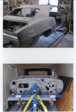

Doesn't look like it had the ZL/2 hood from new. Not according to the firewall picture anyway..BKH
