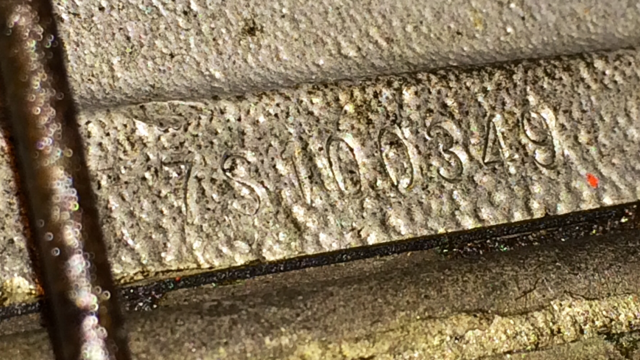

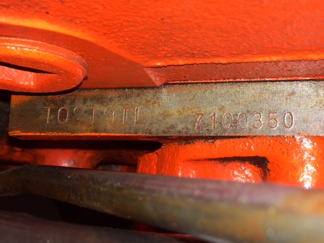

Did GM use the same stamp for the trans as they did for the VIN on the engine?
I am assuming they did, like mopar, but had to ask.
I recently noticed a difference on a post 1970 car that made me wonder.

thanks. I recently got confused when I saw the 1's characters on a survivor car, block vs trans. The 1s on the trans looked more like vertical lines. thanks.

Hi Stephano, now that you responded, when I looked at the 74 454 vette you had listed forsale, it was the trans stamp that made me wonder about the top of the 1's. It sure looks like it was the same stamp on everything else. Thanks!

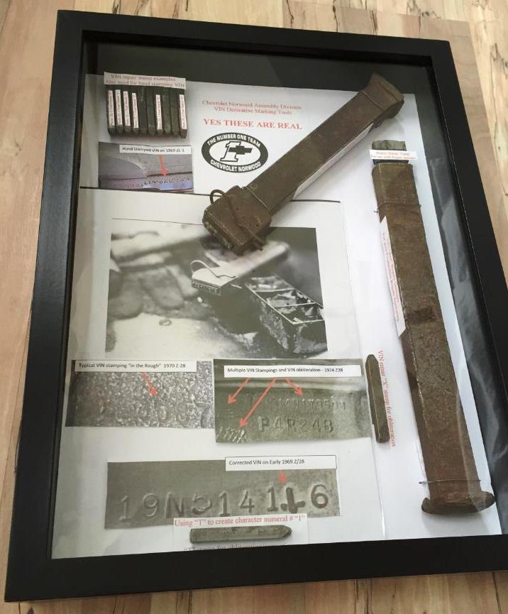

Here are Examples of Factory Stampings.
First is the Original Muncie , late build,
10 C &amp; 661 case with drain and fill.
69 Z/28. M 21.
the '777' vin stamp is Actually *111*
Second is an NOS 302 Engine Assembly
From the Flint Michigan engine plant.
Note Date # 7 &amp; letter capital I in lieu
of 71
Day Two Specialties /High Quality Muscle Car Parts.

I understand the character substitutions mentioned (7 for a 1 in the one example, and I for a 1 in the other example). But shouldn't the substitutions of characters be same on block and trans if using the same stamp?
Old 11-24-2015, 04:53 PM
70 copo 70 copo is offline
Posts: 3,834
Thanks: 219
Thanked 1,241 Times in 578 Posts
Default Re: engine and trans pad stamps
Yes, unless the engine or transmission was replaced as part of an in plant repair at AGR. Then another set of stamps could have been used along with alternate stamping locations.
