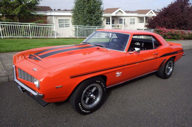

This is the car that was at Seattle Mecum in 2015. My friend Gary owns it now, and he's floored at the quality of the restoration (he's super picky), and how well it has held up since '07. I was guessing Super Car Workshop, but I can't find anything that confirms that or identifies another restorer. All info welcome, PM if you don't want to shout it out in front of the world. Thanks

Not a SCW car. I think thats the old Marc McCartney Yenko,then Ron Vohees, then Steve Sandlin who put white stripes on it, then Irwin Kroi who put the correct black back on...BKH

Thanks for clearing that up Brian, and for the suggested owner history. I think I have the old Dec '82 Super Chevy with the Marc McCartney-owned feature article, I will give that to Gary. Nobody knows who did the restoration work? The paint, fit and finish are exceptional everywhere on the car.

Hemming Muscle Machines did a feature on Irwin's ZL-1 Camaro several years ago and in the article it states he had that car restored by Corvette specialist Bob Caruso at Billy Bob's Fast Expensive Cars. In the article it also states they had previously done work on some of Irwin's other cars. I don't know if they restored the Yenko, but they do have a website with a phone number so the new owner could call and ask them.
