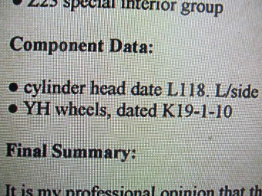

A former colleague of mine is looking at this car. This would be his first serious collector car so I offered to help him dig up any history you guys might have with the car. Any feedback would be great...thanks!!

For all the effort [and expense] that went into the otherwise beautiful restoration they put the wrong stripe color on it. Should have black stripes as noted on the certification. At this point very expensive to correct.
Some other details:
Trim height incorrect
Should not have a trunk mat
Should not have chrome tailpipes
Incorrect Posi tag; should have the red tag mounted on the fill plug
Spare wheel back side should be black
BV is a 4.10 axle, not 3.73 as stated
Rocker covers should not be polished
firewall graffiti
extra labels in the engine bay
Should not be insulators under fuel tank straps
No Camaro, not even a ZL1, had the Corvette L88/ZL1 octane warning label. On a Corvette it was placed on the console, not pasted on the glass.
‘Can-Am 302’ sticker on the air cleaner is home-made and makes no sense. The 302 engine existed for the Trans-Am series. Had nothing to do with the Can-Am series.
Great car if you like plaques, trophies, badges.

For all the pics of jerrys reports and #s i would want to see the eng pad stamp without paint and the orig invoice as stated that he had for that kinda $$. Like the others stated very nice piece if u want eye candy thou..

Could have been a very nice and correct car, the happy marks are really creative [img]<<GRAEMLIN_URL>>/rolleyes.gif[/img], a bunch of hardware issues that are not that hard to correct.
And William, how did you miss my favorite the chi-neez brake booster.. [img]<<GRAEMLIN_URL>>/naughty.gif[/img]
And really to bad about the stripes [img]<<GRAEMLIN_URL>>/no.gif[/img], ouch !

I wouldn't worry about the stripes. I would want to see a pic of the bare engine pad though. Was restored by a member here so maybe he can comment ?

The repo boosters are really easy to tell by the very defined edges of the triangular shaped recesses.
