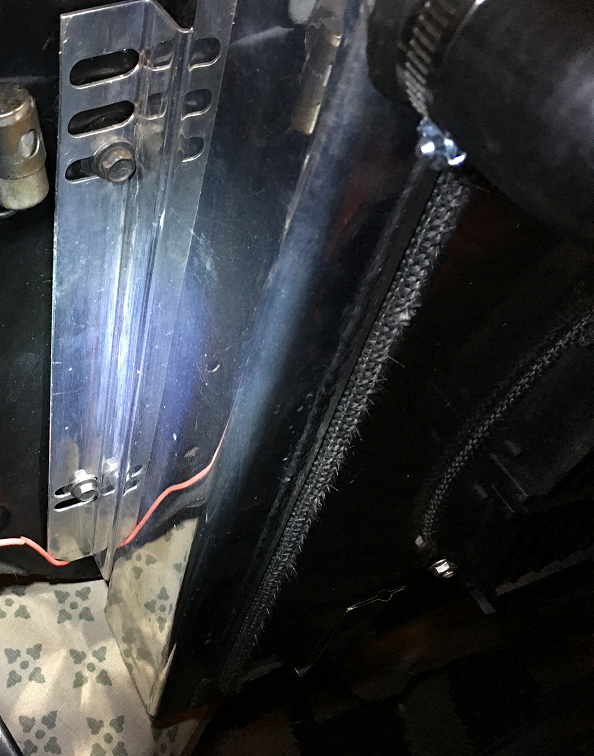

Old 07-08-2016, 11:29 AM
cook_dw's Avatar
cook_dw cook_dw is offline
Join Date: Oct 2003
Posts: 4,377
Thanks: 670
Thanked 1,718 Times in 657 Posts
Default Re: Be Cool radiator 69 Camaro BB
Heres a pic of the radiator in the blue car.
Old 07-08-2016, 12:30 PM
HawkX66's Avatar
HawkX66 HawkX66 is offline
Join Date: Sep 2015
Location: VA/MA
Posts: 1,021
Thanks: 1,015
Thanked 225 Times in 134 Posts
<div class="ubbcode-block"><div class="ubbcode-header">Originally Posted By: cook_dw</div><div class="ubbcode-body">Heres a pic of the radiator in the blue car.
</div></div>
Great pic Darrel. Thanks. Is your lower mount going into a captured nut or is it something different? It's not the same as the top is it? Mine just has a blank hole right there. I'm running an A/M core support right now. My original looks like it might have a nut mounted in rubber like maybe a barrel nut? It wouldn't be a big deal here, but the back side of the hole is in a boxed in area that I can't put a nut on.
EDIT: Yep, looks like I'm missing a radiator expansion nut. I hate that... Thanks for the pic Darrel!
-Dave
Semper Fi!
69 Camaro SS396 L34 X66
Old 07-08-2016, 01:37 PM
cook_dw's Avatar
Join Date: Oct 2003
Posts: 4,377
Thanks: 670
Both nuts are the same. Not original but correct size for the expansion nuts.
