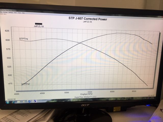

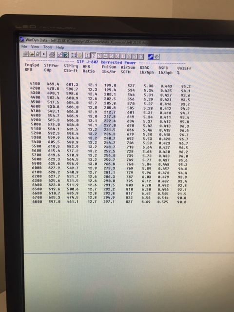

Dyno sheet

Old 10-23-2018, 01:44 AM
mockingbird812's Avatar
Location: Dayton
Posts: 14,403
Thanks: 908
628 HP and 606 TQ ain’t bad at all!!

Old 10-23-2018, 01:48 AM

Jerry knows the ins and outs of a BBC cast iron or aluminum :-)
Hope all so well Jerry.

Old 10-23-2018, 03:08 PM
big gear head's Avatar
big gear head big gear head is online now
Join Date: Mar 2012
Location: KY
Posts: 3,371
Thanks: 5,597
Thanked 1,449 Times in 761 Posts
Man, that's nice! What is the compression ratio?

Old 10-23-2018, 04:09 PM
jerry j jerry j is offline
Join Date: Mar 2005
Location: crete il.
Posts: 120
Thanked 22 Times in 10 Posts
Stock 12 to 1 on VP 110 gas

Old 10-23-2018, 09:16 PM
1971ls6's Avatar
1971ls6 1971ls6 is offline
Join Date: Mar 2011
Posts: 194
Thanks: 16
Thanked 76 Times in 52 Posts
Headers?
What Cam?
Nice numbers

Old 10-23-2018, 11:26 PM
Stefano Stefano is offline
Join Date: Oct 2001
Location: Land of Lincoln
Posts: 9,029
Thanks: 5
Congrats, those are huge numbers especially if stock heads and bore!
