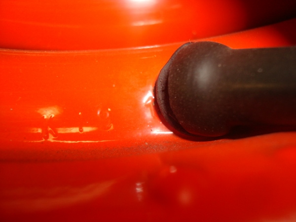

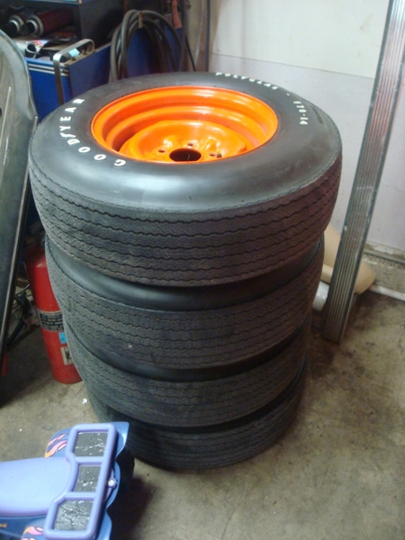

I am thinking about selling theese and not sure about the date. The paint is to nice to sand down. It looks like K19 1 23 XT is that a known date for a xt wheel

Looks more like a K-1-8 to me, and the 1 probably should have an 0, 1, or 2 that dropped off in the valve stem hole. Maybe another wheel would confirm the date more clearly.

K19 1 23 XT = January 23 1969
K = KH
1 = Romulus, MI wheel plant
9 = 1969
1 = January
23 = 23rd day
XT = application

yes , known date
