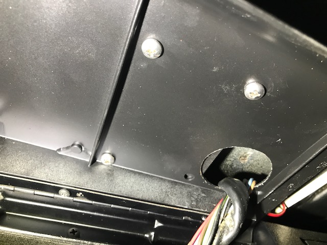

Yes, but you simply tape the template to the lid an drill the two large holes for the cable, and four bracket mounting holes. The template has been photo copied many times so check the bracket mounting holes to the template before drilling. I've,done it several times it's a piece of cake.

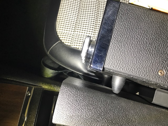

My 68 Dana has the 8 track. I'll go take a couple pics.

Here's the template, which I already emailed. The picture of the underside Charley's was not done correctly per factory instructions. I've had several cars survivor cars with 8tracks and the lids were modified per the template.
