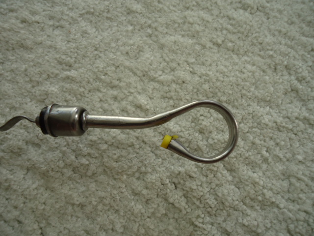

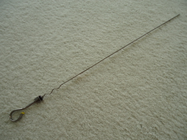

Ok member’s out there. What is the correct Oil Dipstick Handle.
Is it the Round Handle Yellow Tip or the Flat Handle Yellow Tip.
Any help would be greatly appreciated.
Thank You!

Flat handle...Part#3925599,installed on the assembly line as original equipment on:
1968 Camaro-Nova-Chevelle w/396cid.
1969 Camaro-Nova-Chevelle w/396cid. & 427cid.
1970 ALL vehicles w/396cid. & 454cid.
Measures roughly 24-1/4 long.
Shows USE GM6041-M-QUALITY MS OIL E near the bottom of the stick.

I am looking for this exact dipstick and tube.Flat handle...Part#3925599,installed on the assembly line as original equipment on:
Is this one for sale by any chance??
Thanks and Happy New Year
Custom Cam /Engine Dyno and Spintron Operator at Brian Tooley Racing R@D
84 Mustang/Hertz Rent-a-Car
438CI 5.58@123 8.80@147 On Radials ALL MOTOR
Powered by my 13 year olds engine program
68 NOVA 396-375 HP F.A.S.T. Project
Old 12-29-2017, 07:06 PM
Posts: 20,897
Crossbreed383
If you're asking me with those photos,I'm sorry no,because it sold earlier this year on this site.
