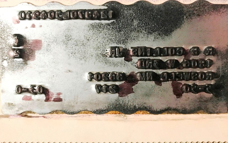

I am finally in the process of buying a 1970 z28 camaro and wanted to confirm if the protecto plate looks real? The plate does not have engine codes as i seen before. But it is still attached to the warranty card.
Does the image of the build sheet look real?
Thanks for the help!
Attachments - The Supercar Registry Protecto_Plate.jpg IMG_0586.JPG Build_sheet2.jpg Build_sheet1.jpg

probably a second owner plate that was made up for the remaining warranty coverage.

I've never seen a POP like that for a 70 Camaro but I guess it could be like Wilma said, made for 2nd owner while still under factory warranty.
I compared your picture of the buildsheet to pictures of others I have from known originals and it looks real, right down to the details on spacing, letters overlaping lines and oddball characters.

The name on the protecto plate is the same as the original owner and sales documents state and old titles. It just seemed odd no engine or axle data?
Does the protecto not add any value that its not filled out correctly?

I had a car with two POP's. The original owner lost his and they made another with just the VIN. Later, he found the original and I got both. They did put limited information on a replacement or second owner POP.
