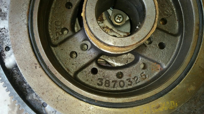

A buddy asked me to post these pictures and to draw on the knowledge base that is here in identifying the parts. There does not seem to be a VIN on the block but he may not be looking in the right place. What help can you provide in identifying this and more importantly, what would a real world value be of it since he has finally decided to let some of his stuff go.
Would this have gone in a car, would it have been service replacement or over the counter sale?
If there are pictures of other parts you would need to identify it, please let me know - I can get them.

I have maintained a ZL1 engine log for some time. The casting sequence # [222] would be, by a wide margin, the highest number installed in a production ZL1 Camaro. There should be a number stamped at the top of the rear block face and on each main bearing cap.
Doesn't hurt to check-there may be a VIN stamp on the side of the block adjacent to the oil filter.
My guess, it's an OTC block, built up for racing. Complete engines seem to get $15-$20k; this one is apart so there's that. But, don't see any ugly welds.

Agree it's an OTC engine.
The Carb alone is dated Feb.16th,1974.

shouldnt it of came with a 7115 crank
?????????? Block is dated 3 14 69 ... carb is 5 years after the block, and probably didnt come that way since new. Original Block date on yellow corvette zl1 is 4 29 69

Trying to get the numbers on the caps - are they stamped numbers or casting numbers?

Stamped in .... the 3 raised numbers on the caps are the part numbers.....great motor.
