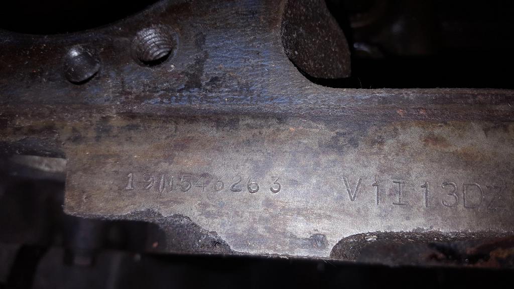

Just trying to verify the 2 blocks
Attachments - The Supercar Registry fullsizeoutput-84e.jpg fullsizeoutput-84c.jpg

Both appear to be authentic to me. Top one may have been V0306DZ originally.
Would be nice to do a search for the cars these blocks were born with.

My 0307 is similar

Both appear legit... the N543xxx vin didn't come out of NC did it? There is a Dusk blue dk blue car sold out of ATL now in Ohio which is a mid nov car which I traced the engine back to NC - in that VIN range.

Thanks, gentlemen for your input. I am doing a search for the one with the VIN now, I will update any new info.

What was someone thinking ? the 86 day of March? Too bad, don’t think it’s a Flint mistake, someone added the 8

I just got off the phone with the current owner of the Z/28 for this engine, he switched the car over to an LS conversion & has no interest in the original engine & has no interest in selling the car. End of story.

That 0386 block is not the only one out there with an "8" where a "0" should be.
I would bet the 8 was there first and someone tried to correct it.
