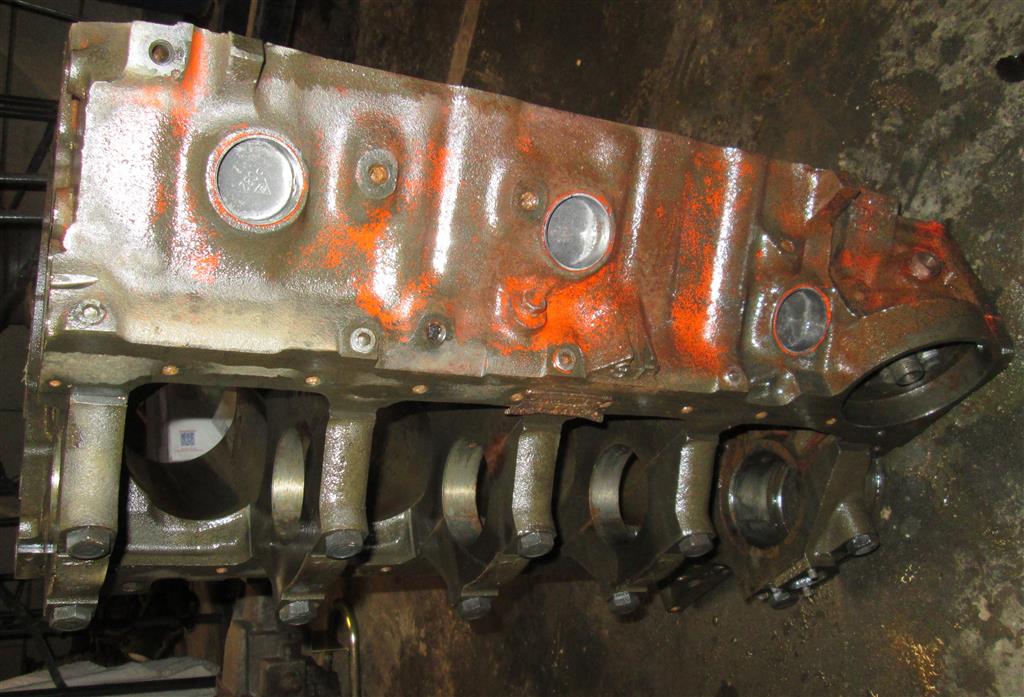

I posted a few pictures of the progress so far. There is a picture of the cylinder head before, after soaking, then after blasting to remove the black coating that formed. The blasting was very fast and would have taken hours if not derusted first.

Here are a few more pictures of the first block before and after. I decided to pull the main bearings that were still there. When pulled the block, I realized the cam bearings were installed and the acid appeared to have no effect on them.

Here are a few more of the 396 block. The last ones show it after it was hosed off and sprayed with WD-40.
