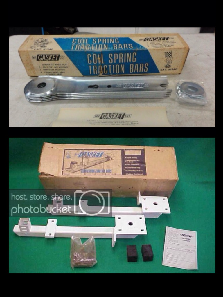

Does anyone know the history of the No Hop Bars used on GM A body cars?
We ran a set on our car in the early 80's.I think those were made by Mr Gasket.
I do remember that they were cast out of aluminum unlike all the other ones that I have seen, that were cast out of cast-iron.
I was wondering who made them first and what year they were introduced to the market place.
Thanks
Bernhard

I have two sets, one goes to my 64 GTO and one to my 70 GTO, The 70 set has been with the car since day 2, and the 64 set around the same year. The same goes for the Black air bags they have. It appears to be Two different manufacturers though. One states No Hop. They are both mint as the cars have never been in the elements, Just track time

I’ve always assumed Genuine Suspension was the originator with many copycats that followed. Art Morrison/Dick Gazan probably had the most high quality version that were available in the ‘90’s. They definitely work well by re-locating the intersection points. I’ve always thought it was cool to see a 12 bolt at a swap meet with those distinctive holes drilled thru the webbing that indicate a set was once installed!
